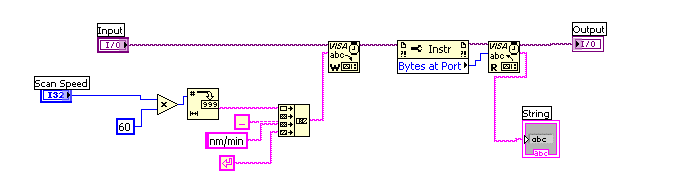

Another new problem is that, there is an even called 'GOTO', which ask the SP 2150i to move to a new wavelength, including 2 simple Sub_VI
scanspeed.vi:
goto.vi
The problem is that, after I run this event, seems data bytes are stuck in the COM terminal. I guess it's from the two read operation in the sub_vis...

2. A new problem emerges... When I open the LV program from the file, run it for the first time, it always gives me the response of 0 nm/s scanspeed, 0 nm wavelength and 0 grating no. However, after I stop the program and run it again, the answer is right. Why so odd?  Not odd at all.  Very predicable.  You keep using the Bytes at Port property node right after you send a command to the instrument.  That means that the first time the program runs the bytes at port will return 0 and not try to read the buffer.  After that you are reading data from buffer that is acutally a reply from a previous command.  Try putting a probe on the value returned by Bytes at port and see for yourself.
3. I noted your latest reply, which shows a 15 byte constant of the reading operation. Is it better to set a property node??  Get rid of the property nodes.
