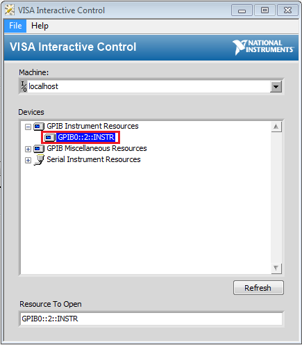

The problem is that you bought this device from a distributor and not directly from NI...
What do you get when you go to Tools»NI-VISA»VISA Interactive Control?
Do you see anything like this or nothing at all?

When I go to the VISA Interactive Control tool, I can't find any device.
Moreover, the two LEDs "Ready" and "Active" on the GPIB device are off.
