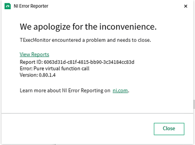

I am developing a c++/clr testing application with a PXI-4070 and a PXIe-4080 using IVI DMM functions.
The DMM functions correctly and I am able to get the correct measurements, but when I exit my application and everything shuts down I get this error from NI Error Reporter.

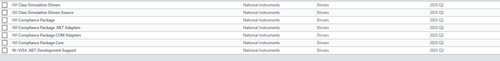

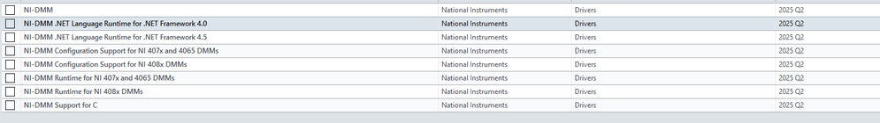

Here is installed ivi and dmm drivers:
