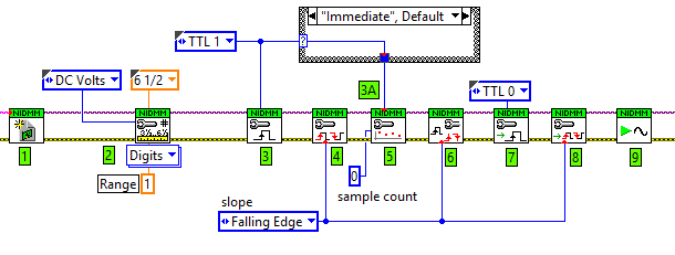

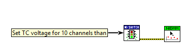

Than what I do is basically -
1. Set 10 thermocouple  channels
2. start scan
3. measure with DMM
4. Repeat for all required thermocouple values

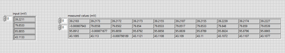

for some reason I find that channels are skipped with the following pattern:
Notice the second row in the fist column the third row in the second channel...
Any one had similar issue?

Such a stupid mistake...
If you scan 10 channels, your scan list should be 0:9!
Well I guess sometimes talking about the problem helps you solve it...
