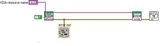

I installed the LV driver for a Tektronix AFG3022B signal generator, called tkafg3k.  I've been modifying some of the examples
provided and all seems to be well. However, I do NOT want to perform an instrument reset when I initialize the instrument...
done using tkafg3k Initialize.vi because the reset briefly switches off the voltage outputs and I cannot do that to the equipment
I am driving with the AFG3022B  There is a Reset(T) input to  tkafg3k Initialize.vi, but if I change it to a False I get this error :
Error -1073807339 occurred at VISA Read in tkafg3k Error Query.vi->tkafg3k Initialize.vi->tkafg3k_0.vi
Possible reason(s):
VISA:  (Hex 0xBFFF0015) Timeout expired before operation completed.
even in the simplest vi which just initializes and then closes the instrument. VISA resource name is correct.
Anyone know how I can get around this?

Hi Michael,
Thanks for your reply. I'll answer your questions in order.
I delved down into tkafg3k Initialize.vi, the Timeout period in the VISA property Node is set to 10000ms - so already
longer than the 2000ms recommended in the KB link you sent. So far I have not tried changing it.
I'm running LabVIEW 8.6 Professional Development System with Mathscript, NI-VISA 4.4, the driver information is:
Instrument Driver Technology:  Plug and Play
Supported Language(s):  LabVIEW
Supported Model(s):  AFG3021, AFG3022, AFG3101, AFG3102, AFG3251, AFG3252, AFG3021B, AFG3022B,AFG3011
Model(s) Tested:  AFG3252, AFG3022B, AFG3011
Interface(s):  GPIB, Ethernet, USB
Firmware Revision Tested:  1.0.4, 3.0.0
Certified:  Yes
NI Supported:  Yes
Source Code Available:  Yes
Driver Revision:  1.3.2
Original Release Date:  11/21/2006
Current Revision Date:  03/14/2011
I want to incorporate control on my AFG3022B into an existing vi I have which is controlling an experiment. I'm testing
the AFG alone to start. I want to drive the two channels with Sine waves at 100Hz, but 90 deg out of phase with
each other (can't find a way to set the phase but that's another problem!).  The Sine amplitudes will be set
on initialise, but the DC offset to each channel will be a variable at each loop iteration - based on feedback from
the experiment. Something like this: Please note True constant on the Reset input to tkafg3k Initialise vi which
is the default.
My instrument is switched on and outputting pre-defined voltages on each channel to the equipment I'm driving.
When I run attached vi, the instrument briefly resets which changes the wavefrom properties and turns off both
voltage outputs - I really need to avoid this. It then sets the waveforms in the attached vi correctly. All takes
about 1s, and I can run it many times changing waveform properties etc.
If I change the Reset input on tkafg3k Initialise vi to a False constant I get:
Error -1073807339 occurred at VISA Read in tkafg3k Error Query.vi->tkafg3k Close.vi->tkafg3k_1.vi
..the original error I posted about.
If I change it back to a True constant I get:
Error -1073807346 occurred at VISA Write in tkafg3k Error Query.vi->tkafg3k Configure Standard Waveform.vi->tkafg3k_1.vi
VISA:  (Hex 0xBFFF000E) The given session or object reference is invalid.
I then have to switch off/on the AFG before I can start running vi s again. So, I have run the vi many times and I can
see on its front panel exactly what the vi is doing to the instrument and when voltage outputs are switched on/off.
Any further help much appreciated, as this is taking far too long and it should be easy!

I have cheated my way around this problem for now - see attachment - but I would still appreciate some help
with solving it in a sensible fashion.  In tkafg3k Initialize.vi, when Reset is set to F, another vi is run called
 _tkafg3k Default Instrument Setup.vi
I have now just set the False case to do nothing, so I avoid the problem, the instrument does not reset
before applying the waveforms I want.
