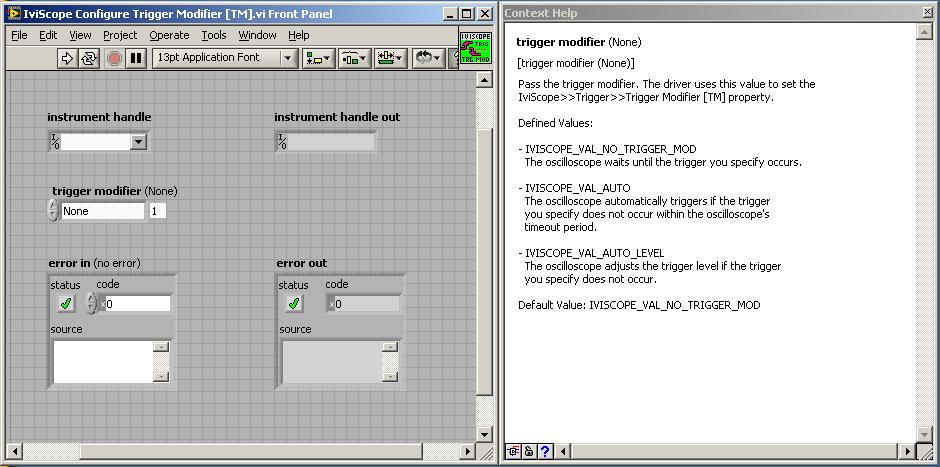

Hello Unai,
     Something that might help is configuring the trigger modifier:
 24496i508BC107193CBCA6
If that does not help, please isolate the problem down to the minimum amount of code that reproduces the problem, take an NI-Spy capture of the problem occuring, and post both of them to this thread.  Please also let us know which instrument you are using and which exact instrument driver.
For in-depth troubleshooting steps, please see the Instrument Driver Troubleshooting Guide.
NathanT
