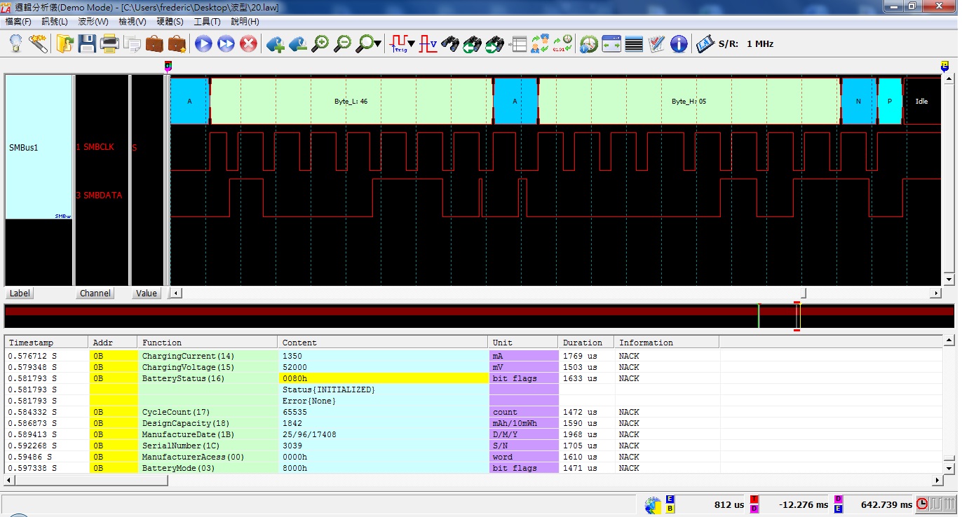

Now , i have another problem, when i use NI8452(Slave) to communicate to DUT(Master).
DUT will Write command to Slave by polling, and then Slave will response the L Byte and H Byte to DUT.
When the NI8452 responsed the L Byte and H Byte to Master. Between the L Byte and H Byte have a High bit(not ACK).
I want to know why,it is the problem from 8452.

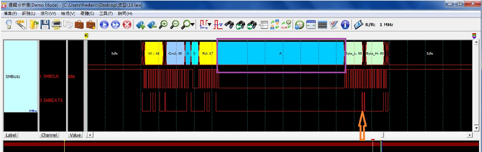

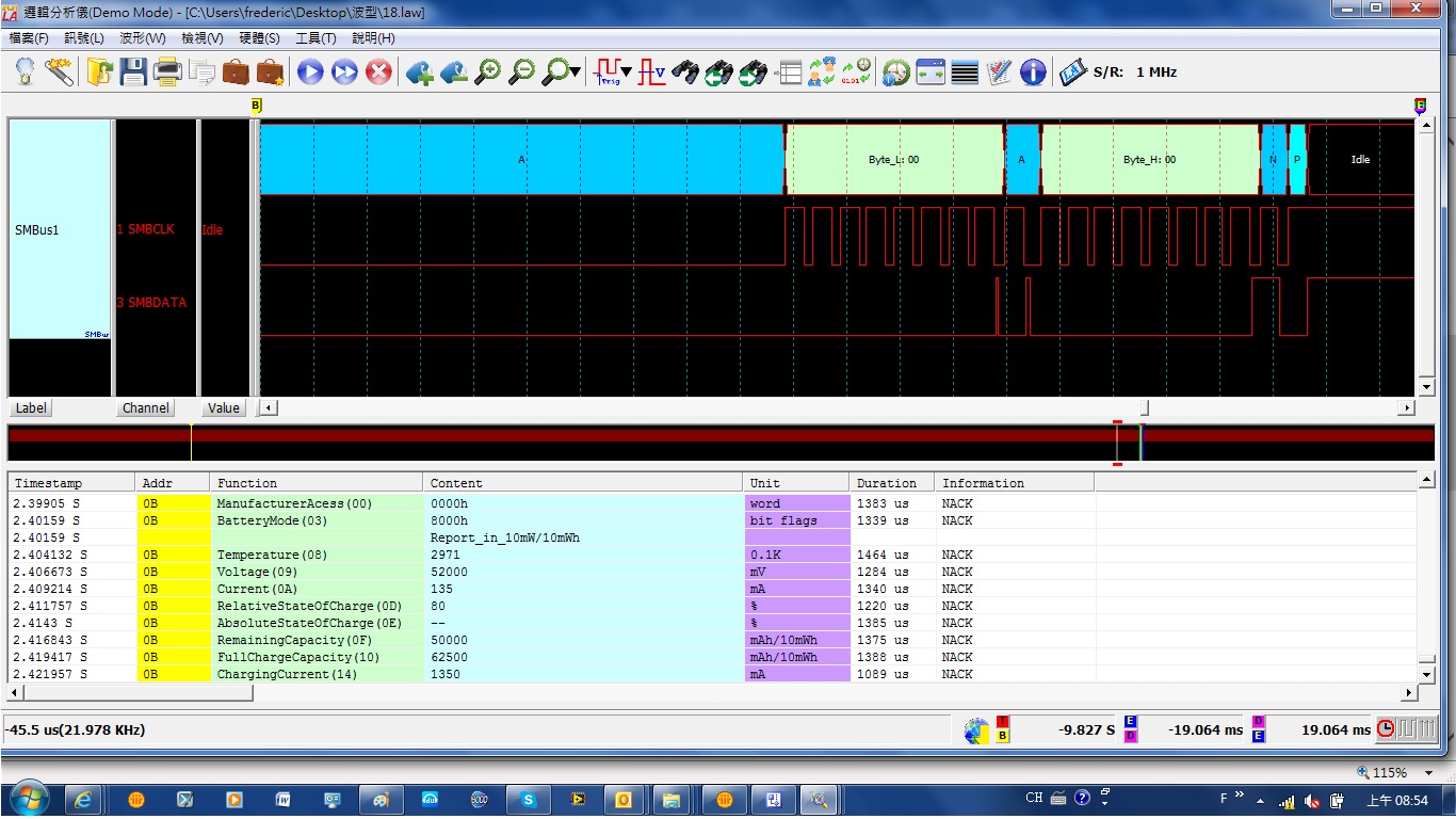

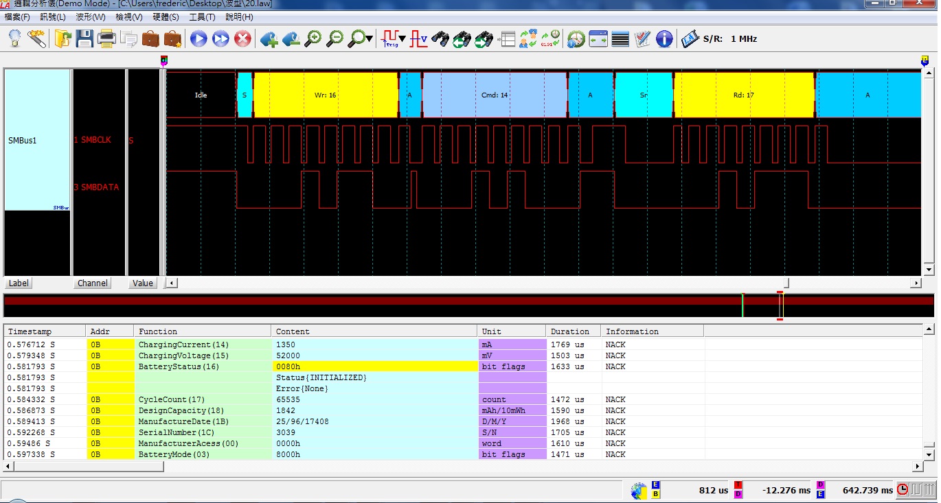

another problem is the ACK(Slave to Master before sending data) too long, have some idea to shorten ACK Clock Stretching.AckData question.jpg
Message 3 of 15
(8,352 Views)
Hi kk,
The time in the region below seem not Ack.
It looks like it is the slave which is causing the delay.
And the 845x driver will not cause the device interrupt.
Maybe you need to check the connect between the 8452 and your slave.
Chloe.

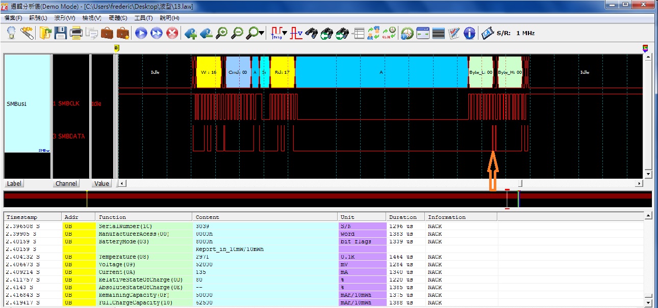

Hi KK,
What is your master device?
Which is SDA or SCL line on the logic analyzer ?
I want to see more clear picture to check the latency state(ACK or restart time).
FIrst Row is SCK Line.
Second Row is SDA Line.

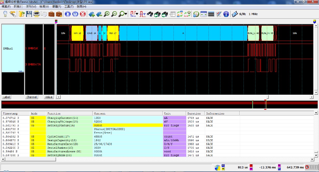

Hi Frederic,
It looks like clock stretching.
But there is no documentation that indicates the exact length of the clock stretching caused by our slave API.
I will help you to ask NIC for the documentation, or the slave API timing issue.
Chloe

Hi Frederic,
We got the response from NIC R&D :
The delay in the picture is clock stretching. Notice that the long acknowledge time is on a read operation. The 845x hardware is asking the software for the data being requested. Once the software puts the data into the hardware buffer the slave releases the SCL line and the response continues.
The battery probably implements the data registers in hardware, therefore when data is requested it can be made available much faster than the the software version.
If there is any problem, please let me know.
