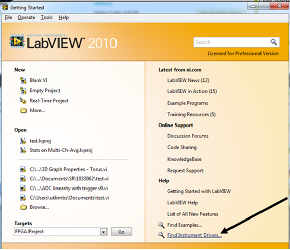

Before creating your own driver did you have a look to see if any of our users have uploaded a driver for this device? On the LabVIEW splash screen there is an option to search for drivers.
If you plug in your robotic arm and select scan for instruments, this will tell you if there is a driver already available.

Ok I uninstalled the drivers I made for the device and tried the "find instrument driver" tool no luck, I had previously manually checked your website at the start of this process any way.
