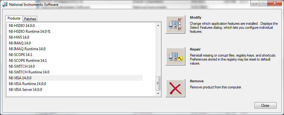

I had Visual Studio 2013 Professional installed prior to VISA install.  From Start --> uninstall a program --> National Instruments

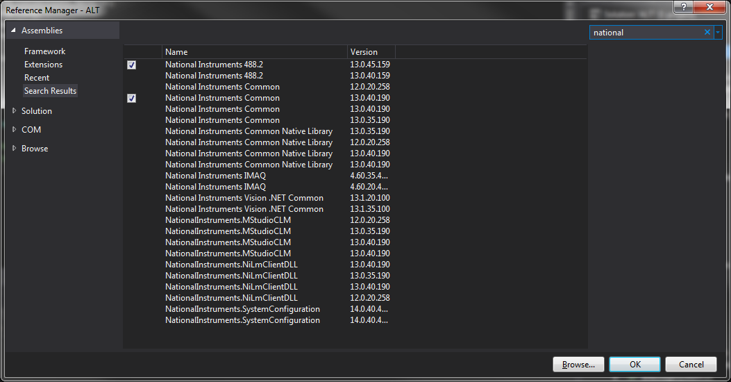

So VISA seems to be installed but through VS I don't see the reference
Any advice?
