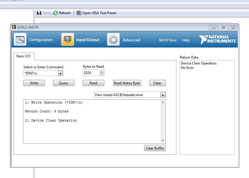

Do you have NI MAX installed? How are you addressing your instruments? You should be able to see all devices connected and their addresses if you have it installed. Are you using one PCI-GPIB card to control all devices or are they split between two? If you don't have NI MAX you can get it here. You'll need NI-VISA 5.4  to use the test panels.
The first step is to verify the addressing of all the GPIB devices within NI-MAX:
1. Open NI MAX - The GPIB controller and devices with their addresses will be listed on the left hand side.
Then try and write using the open VISA test panel and write to one device.
3. Click the device you want to test and then click "Open VISA Test Panel", a dialog box will open.
4. Click input & Output and send a cmd to the device.
5. Test all your devices.

Yes, Max is installed and I am able to communicate with instruments in the box  per your screen shot. I do have to change the "qwery"string in some cases as they respond to the ID? and or ID?/n instead of IDN? I also have some old instruments  that do not respond to the ID request but they do follow control cammands sent to them.
I have not tried all the instruments in Max however I have thoroughly tested the ones called out in the programs I am  testing and fail in DOS.
