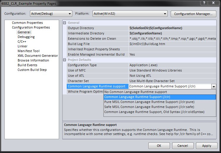

So there are a few changes you need to make to enable use of .NET modules in Visual C++. With a C++»General»Empty Project, I added a source file and right clicked on the project properties to enable common language runtime support.

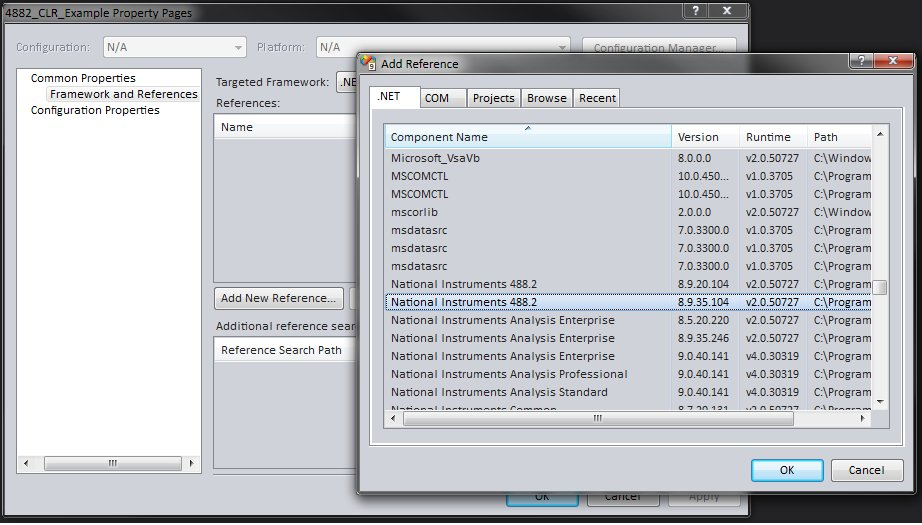

I then added a reference to National Instruments 488.2 .NET from the right-click menu and the subsequent Add New Reference dialog.
I was then able to run some simple code demonstrating successful use of the NI-488.2 Device class, with the following statements included.

- Add the NI .NET interface to the project: go to "Project | Properties" (Alt-F7). Under Common Properties, select Framework and References, then click on the "Add new reference" button, and select the "National Instruments 488.2" .NET interface, then OK.
