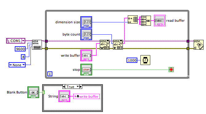

Here is what your 1 fiso VI BD looks like after clean up (with manual assist):
Note that your Blank Button will likely be read exactly one time and that shortly after the VI starts running. Pressing the button later will have no effect.  This is probably not what you had in mind.  This is basic dataflow and is fundamental to the way LabVIEW operates.

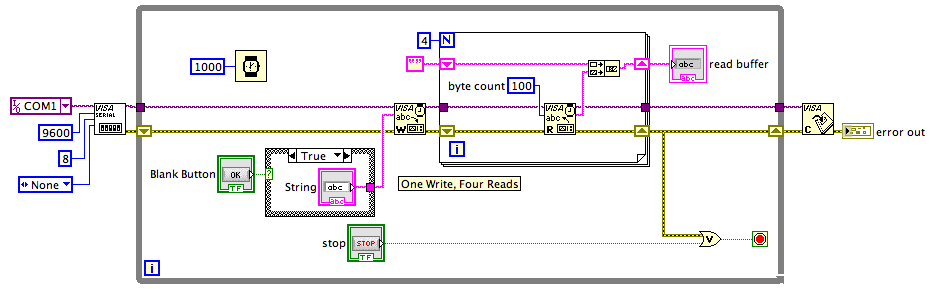

This is possibly what Dennis had in mind when he recommended four reads and concatenate:
Note that this has the case structure controlled by Blank Button inside the while loop where it will be read every time the loop iterates. The false case contains an empty string. (Even better would be to put all the Write and Read functions inside the case structure. You probably get timeout errors or other strange behavior when trying to read after no command was written.) No local variable required. In LV the wire is the variable, not the control or indicator. Naming front panel objects "...Buffer" suggests a text language programming background.  To take advantage of the power of LV you need to learn how to use the dataflow paradigm.
