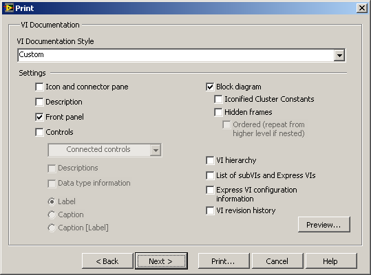

I printed my block diagram and the "case" structures displayed the option with a single wire going through.

If you also select "hidden frames" you get all frames printed.

We print whichever frame you have showing. It isn't always the most complex one that is the important one. We leave it to you to choose. As altenbach says, if you want all the frames, enable the "Hidden Frames" option shown in the image you included.
