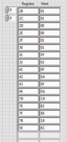

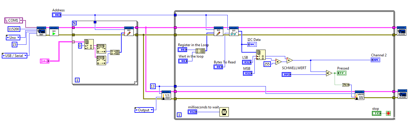

I'd like to use the "Grove - I2C Touch Sensor". But I it didn't work. And i do not know why.
Have someone of you an example for this Sensor?
Or have someone a idea why it dint work?
Thanks alot for any tip, help....
Manuel
http://www.seeedstudio.com/wiki/Grove_-_I2C_Touch_Sensor
Edit:
Thanks for your answer. I have found the problem.
In the attacherment the solution for all with the same problem:

Please post your VI saved for LabVIEW 2009 so that those without 2012 (I should have it soon) can view it.
