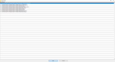

Some questions/comments/observations on this dialog:
  • Pressing Ctrl+Shift+O with a clean history and no files already open does nothing rather than either notifying the user or opening a blank dialog.
  • Clicking a blank line closes the dialog, opens a (random? - if the list is too short to fill the dialog, this will be the first vi in the list) vi, or gives the following dialog box:
    Maybe it should do nothing instead?

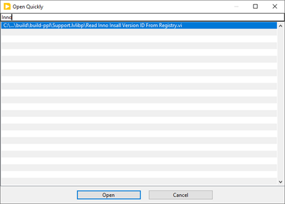

  •  There is a noticeable delay for each letter when typing in the filter dialog for a complex project.  Note that the VM I am using has a hard drive instead of a solid state.  Would it be better to only update the filter when no character has been typed for a certain amount of time (maybe a second?)?
  • VIs in PPLs include the (otherwise invisible to the user unless calling from TestStand) folder path within the PPL in the path instead of either nothing or the virtual folders.

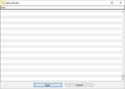

  • The scrollbar doesn't reset/adjust when you type into the filter field - you can easily end up scrolled well beyond the last result if you had scrolled in the full list before typing.

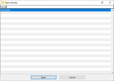

  • If someone blindly added dependencies to their project and managed to add System or mscorlib (which for some reason show up with vi icons in the Project Explorer despite not being vis), they show up in the Open Quickly dialog also. Other non-LabVIEW files in the project like .seq, .csv, .xml, or .ico files don't show up.
