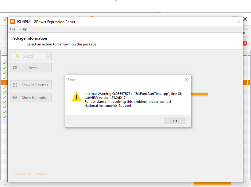

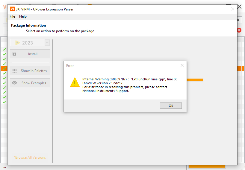

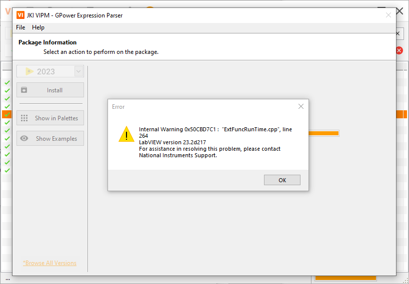

After installation I was prompted with the windows administrator request to allow RegisterAddon.exe to change the PC, so the application is being launched. After excepting this the following events happened in succession. The 2 first warnings came in succession:
Warning 1Warning 1
Warning 2Warning 2
Warning 3Warning 3

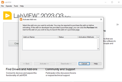

The result when trying to activate the installed package is as follows without closing LabVIEW after the package installation.
User checkingUser checking
After restarting LabVIEW the license file was read and the user was prompted to activate. As a user and product owner I would have expected the license to be available because the user is requested to allow the RegisterAddon program to make changes to the PC. As a control test I tested on the LV2023Q1 and the behavior is the same. In general it would be a better user experience if the license could be activated immediately after installation without restart of LabVIEW, as the products functions are available in the environment, if possible.
