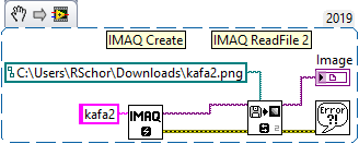

That was quick -- I'm able to edit my earlier response from about 5 minutes ago.  Here is the code -- an IMAQ Create to create the Buffer needed to hold the Image, and an IMAQ ReadFile 2 to read the Image and send it to an Image Display.  The last function is the Simple Error Handler, which (since there was no error) just sits there silently.

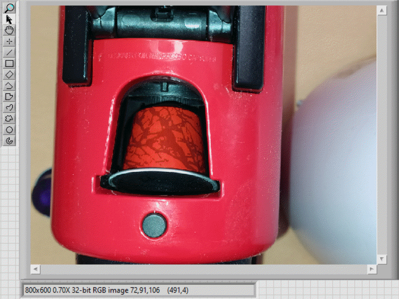

Here's the result:
