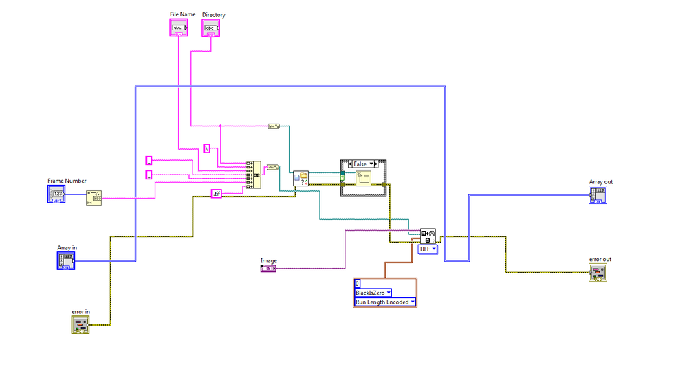

I am trying to save an image in a 12 bit tiff format, following the code it is attached hereby, now the problem is that when I am acquiring in the 12bit mode, the image displayed is actually 12 bit of dynamics, but when I save its values of gray start from 32000, up to 36096, like if it was on 16 bit...

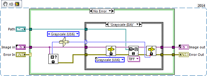

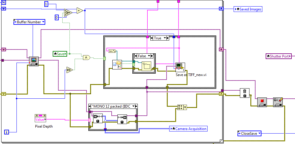

Still no code attached Smiley Wink (only images of the code).
save_as_tiffsave_as_tiff
savesave
Why attach images, when you can insert them:

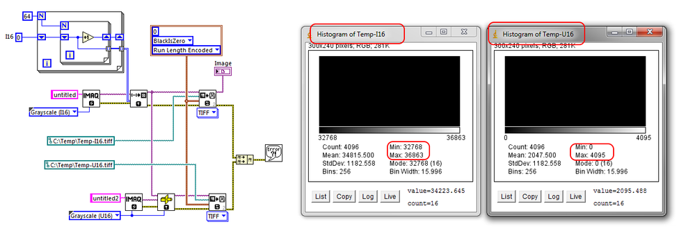

I have seen this behavior before, I16 images saved as TIF by Labview are read by other applications as unsigned 16bit. If your application doesn't need negative pixel values you can try using unsigned 16bit images in Labview as well.

Can you upload those 2 VIs from the pictures (preferably saved in Labview version 2014) and a saved TIFF image?
And which application do you use to verify the pixel values?
Message 8 of 12
(9,140 Views)
Good morning RamonG and thank you again for you help, here you can find the two Vi's (where there first is just a part of a bigger one).
I used ImageJ to open it. I am sorry but I couldn't upload the tiff file since it is not possible.
Thank you again

I think something went wrong with your image type in your code and it's still signed 16bit. See proof of concept below.
You could replace the IMAQ Write File with this attached VI which should work for all image types. It's just the I16 type that has this issue compared with ImageJ.
