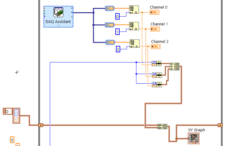

I'm currently struggling with a VI that will use NI-9213 to monitor 16 channels (all with type K thermocouples).  From browsing the forums and looking through examples, I've been able to get the VI to monitor 2 channels and plot them in real-time on an XY Graph.  Now, I'm trying to add a 3rd channel to the plot.  It's giving me errors every time I try to modify it to look at a 3rd channel, saying that the the clusters are different sizes.  I keep thinking that I have updated everything that I need to have, but I continually get this error.

In your DAQ assistant you only have two channels configured.
You also need to change your array bundling like the following. (Use Concatenate Arrays)
I think that should work.

I don't think McDuff's example is going to combine things the way you want them to.  Look in the Example Finder for XY Graph Data Types.  There are two different ways shown there on how to bundle data points together for multiple plots.  You'll have to see which works best for you.  Actually, you should just use a Waveform Graph since your X values are all equally spaced by 1.  There is an example for Waveform Graph Data Types as well.
Also, you can get by with just one index array when you separate your values.  Stretch downwards and you'll get indices 0, 1, 2, .... automatically without constants.  And there is no reason to convert the loop iteration terminal to a double.  It is an integer so leave it an integer.  Get rid of the To Double and change the representation of "Number of Data Points" to I32

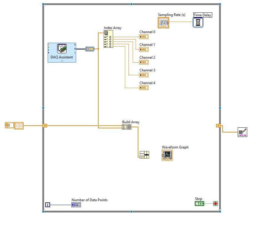

I took your advice and switched things over to a Waveform Graph.  Things still aren't working as I had hoped.  I think my struggles with this stem from my unfamiliarity with arrays in LabVIEW.  I need some practice with them.
Just as a review, here's what I'm trying to do-
  1. Read 5 thermocouples using the NI-9213 (I'm only trying to do 5 now, backed down from the 16 that I originally had)
  2. I would like the data to plot real-time on a graph so that we can see the relations between all channels
  3. At the conclusion (when the stop button is pressed), the data is exported to a text file, which we'll read with Excel
  4. It would also be beneficial to have the plot reset to empty when the VI is first run
I've had luck with the attached code to export the data - that part is working well.  But I'm still really struggling with the graph portion.  Would you be able to offer me some more guidance on how to get 5 plots simultaneously?

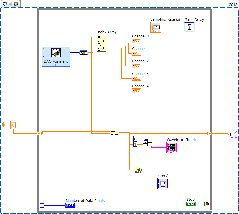

How about trying this?

Here's a dumb question - when I do the build array function bringing in the zeros and then building it with the data from DAQ, it outputs a 2D array where yours outputs a 1D array.  What am I missing there?

You can right click the build array and choose concatenate inputs to have a 1-d array.
I think you want a 2-d array where each row is one of your sensors. Add a 0 and 1 to the of the parts of the bundle, and transpose your array before bundling, do not output the transposed array to the shift, it might work. I do not have LabVIEW here to test.
