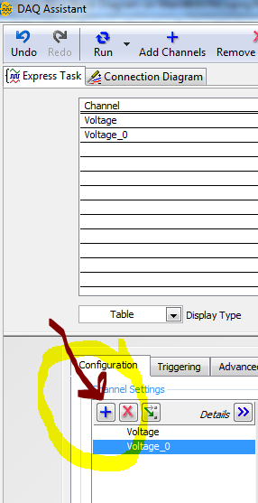

In the DAQ Assistant select Add to Add the other channel
