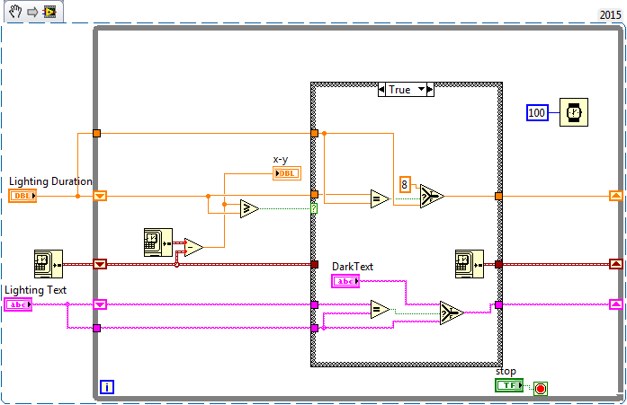

Sample solution. This may give you an hint.

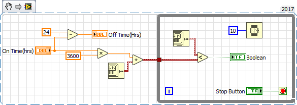

How about something like this?
