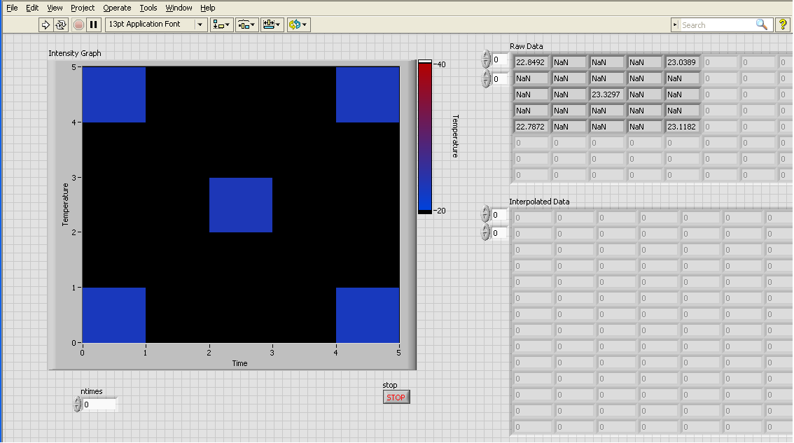

Here is an image that hopefully conveys the idea better.
I have data that looks like this, but a bit more complicated
I would like to take those points, and interpolate between them and create something like this (from Wikipedia page on Bilinear Interpolation)
However the Interpolate function does not overwrite NaN values, so the algorithm doesn't work quite correctly.

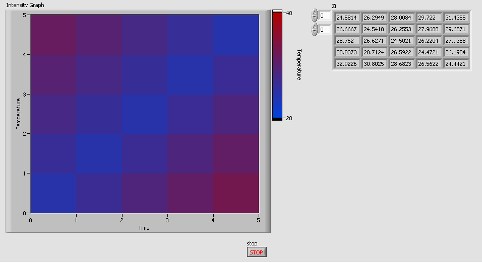

Accepted by topic author Cory_K
Eureka Smiley Happy
It ended up being Interpolate 2D Scattered.vi that did the trick.
Now that all the NaN's are replaced, I get a nice complete field.
Cory K
Message 7 of 18
(16,105 Views)
