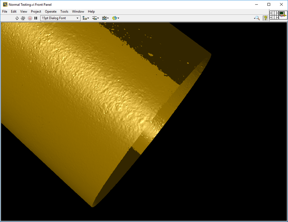

I've attached a basic VI (LV2016) that shows some example data rendered as a point cloud, the reason for wanting to use specular reflections and hence the normals is that this highlights surface details, due to the nature of point clouds each data point needs to be rendered with two faces to allow this detail to be seen from either side of the model.
(The attached VI only has a subset of the data for size reasons)
Point Cloud Scan, note the dark areas of non-reflection due to single sided normalsPoint Cloud Scan, note the dark areas of non-reflection due to single sided normals

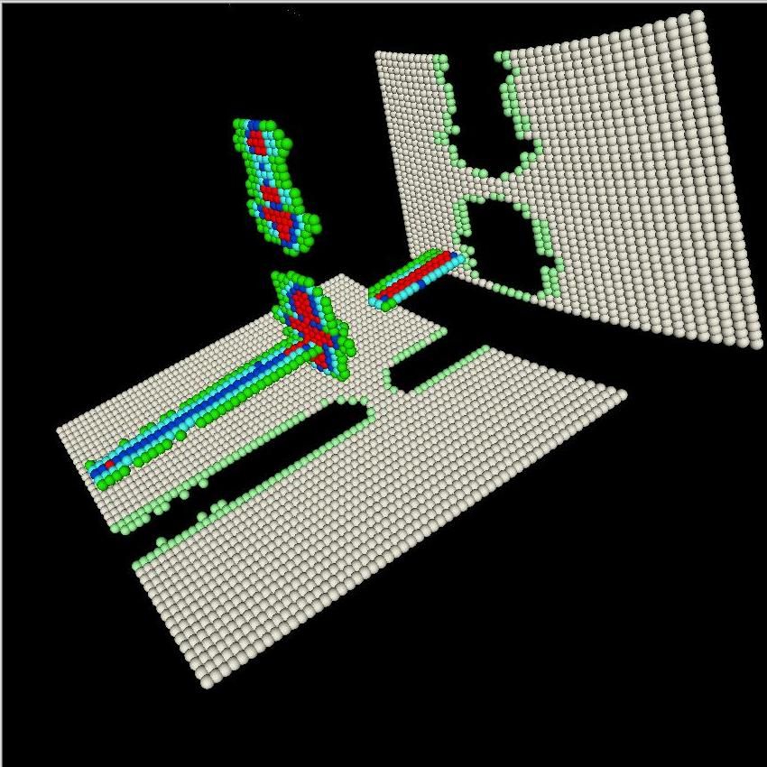

Nice. I render my 3D grid with 3 directional layers
I'll try what happens when I render it with this method.
