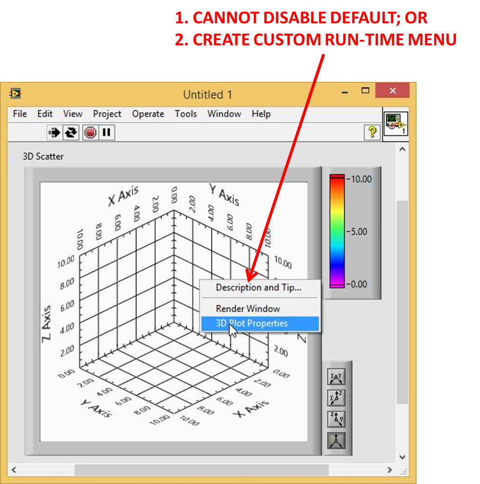

3D Scatter Graph Run-Time Menu
Custom run-time menu for 3D scatter graph does not work (Advanced -> Run-time).
The default run-time menu can also not be turned off.  Disabling it does not work (Advanced -> Run-time -> Disable and VI Properties -> Window Appearance -> Custom -> Allow default run-time short-cut menus (off)).
How do you turn off default run-time menu for 3D scatter graph??  Also, how do you replace it with custom run-time menu??
Want to be able to right-click 3D graph and select from custom run-time menu.  I have seen the work-around here (http://forums.ni.com/t5/LabVIEW/Solution-3DGraph-right-click-menu/m-p/903569/highlight/true#M407348) but it doesn't work.
Any ideas?

Hi Battler
You can override the right click menu using the Shortcut Menu Activation? and Shortcut Menu Selection (User) events.
Not sure what version you're running ... I've attached an example in LV 8.6.
(3,618 Views)
Fantastic, thank you very much 🙂
