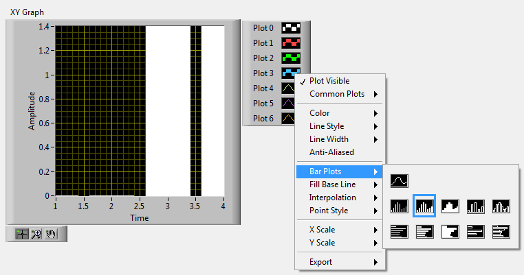

If can't use 3D bar graph for display 2D bar graph
Can I use XY Graph to plot multi bar graph?
Do you have solution for XY graph?
Thank you very much Cat Embarassed
(3,419 Views)
I don't have a solution at hand. But I know that you can use the legend to display the line graph as a bar graph.
(3,408 Views)
Thank you but If i change line graph as a bar graph.
Single plot is OK but Multi plot is not OK because graph will be overlap
Thank you for answer if will try another way. 🙂
