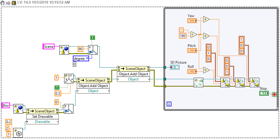

If you want to have the Z-axis as the vertical axis, I think that you have 2 options:
Create a scene, rotate that scene, and then add your object to that scene (as shown below).
PC 3D Picture (mod)_BD.pngOr just rotate the camera view using the invoke node "Setup Camera" of the 3D Picture control.

Thank you for that. I made the mistake of using the reference rather than the object when I was trying. Works well - here is the modified version.
