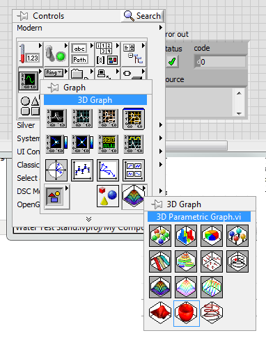

It doesn't work because, as outlined in the thread I linked, the ActiveX Control was not ported to 64 bit by Microsoft, and I would not expect this to change.
There is a Parametric graph designed to replace it located on the Graph>3d Graph palette.  But beware if you try to do anything too fancy with it.
