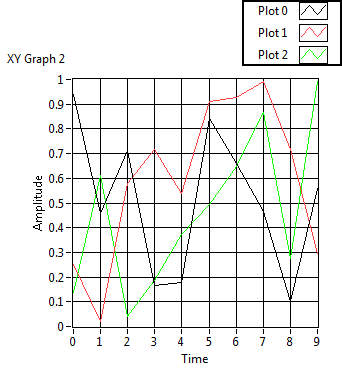

All three Values in the graph with the same VI you attached
Existing code should be modified (Preferably to State machine Architecture)

@PALANIVLT,
HI
the first and second one s working accordingly but when the 3rd boolean is (T) selected then every graph (previous)coming all along.
also just selecting the 3rd boolean is not giving any data which is not the case withh the other two
