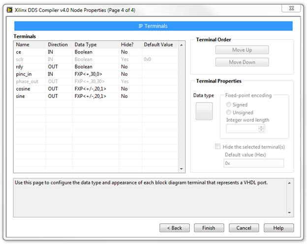

hello Dave. thanks for replying.How to configure DDS and what settings are to be done to make  DDS  generate variable frequency.
Message 14 of 16
(1,033 Views)
I want to generate a variable frequency from 1Hz to 40 MHz
Message 15 of 16
(1,018 Views)
You'll want to use the PINC input like the tutorial I linked did.  You'll want to be sure you manually set the FXP to 30,0 as show in this image.
