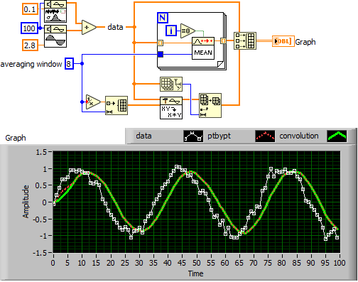

@jithin12 wrote:
Its not working as i have stored my input samples in an array.
You don't tell what is "not working", but if you want to use "mean ptbypt", simply wrap a FOR loop around it and autoindex on the array, right?
 Of course you can also process the array directly, such as convoluting with an array containing 8 elements with a value of 1/8, then trim back to size.
(we need to trim because we don't have the output size option for 1D arrays Smiley Sad)
Note that the ptbypt version has a startup distortion for the first 7 points because fewer points are averaged at the beginning. Of course you might want to shift the subset start for the convolution version to eliminate the filter delay. (not shown)

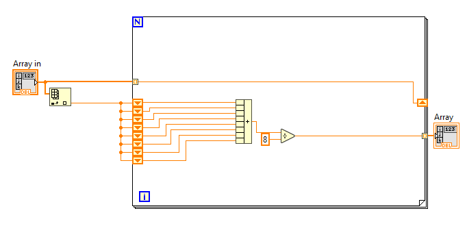

Try the below method.
CLD Using LabVIEW since 2013
Message 8 of 12
(7,182 Views)
That is NOT scalable! Most of the entire code would need to be rewritten if the history length should be changed to something else. What would you do to make a 1000 point average instead? Get a much bigger monitor? 😄
A properly written, scalable solution only need to change a single integer value to work with any history length. try it! 😉
(See also my NI Week presentation (Part II) where I compare four different running average implementations)
