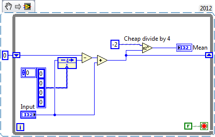

I would do something like this.  I used an array of size 4, so you need to replace those constants with the array length that you want.  Remember an FPGA must have a fixed length array.

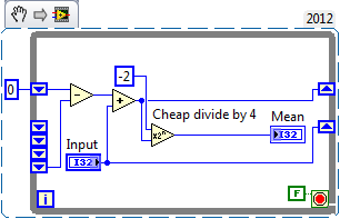

This is what I would do.  I am old fashioned and do not like using floating point on an FPGA, way too expensive.  This is for integer math; it will also work with fixed point inputs.
Using the 4 sample delay will impart some error on the first 4 mean samples, but will be fine after that.  This assumes you don't need the history data as was previously posted.
