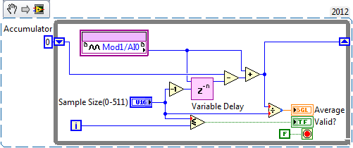

Hello\
Please check the attached pic.
And in place of array I wanted to connect the analog input from the FPGA for example two channels. So please suggest the solution.

@sammir wrote:
Hello\
Do you need to have a variable sample window? For FPGA programming it is better to pick a sample size at design time to save space.  The prior implementations I posted will work for static sample sizes.
You may be able to use the Xilinx RAM based shift register for a variable delay with the subtraction portion depending on what chasis you have.

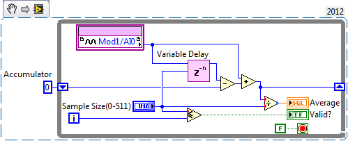

@sammir wrote:
Yes I need to have variable sample window. So please can you attach your program VI so I can test it for my target. So I can see the result and what I am doing wrong
I have cRIO 9082 Chassis with 8 slots.
This should work, although it is untested.  You can duplicate the Z-n blocks for more delay(sample size).  If you use powers of 2 for sample size you can use a bit shift to do the division and save space.  The average won't be valid for the first n samples.
Edit: Had the subtract inputs swapped.
Message 15 of 22
(9,314 Views)
I guess I ran out of edit time.
Actually the decrement on the input of the Z-n is unneeded, the function inludes the 1 sample latency.
I would replace the divide with a multiply by reciprocal.  With the reciprocal as a control loaded by the host system.

That variale delay node is an FPGA IP.  It can't run in a host.  On the host side, you are going to need to implement the array manipulation I performed in my proposed solution.
