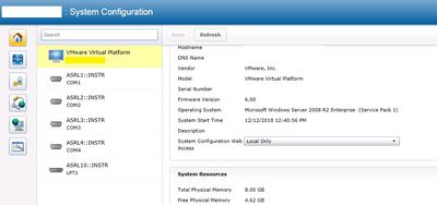

As I understand, the Citadel webservice is hosted in the System web server, which can be accesed and configured from localhost:3580
But, this app lacks a way for configuring headers, or at least I haven't found where could be.
So is there a way to do this? or am I wrong thinking the "Citadel Web service" is the same "system web service"?
