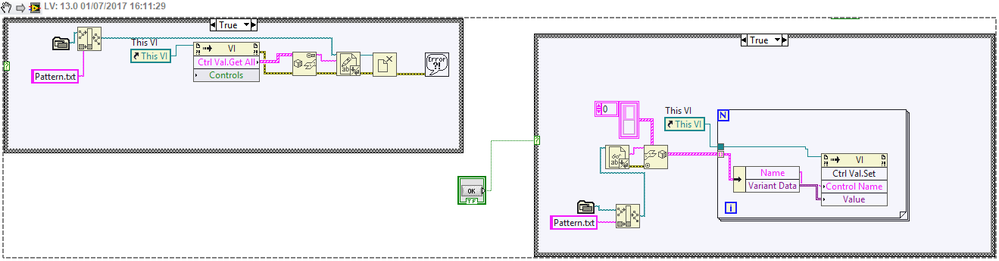

I'm trying to save & load all my front panel values. Load is not working. What am I doing wrong?

I see 2 things.
1.  You are feeding the value of the This VI reference into the Value input.  You are not putting in any of the values you saved to the file.
2.  You create a file that is an array of clusters of Name and Variant Data.  When you read the file and unflatten it, you wired in an array of clusters consisting of a string, integer array, and a string.  Your Flattens and Unflattens just don't match.

Here's a modified version following RavensFan's instructions.
In this case, I right clicked on the cluster wire coming out of the Ctrl Val.Get All node, and clicked Create > Constant. I then dragged the constant value to the second case structure, where I wired it to the type input of the Unflatten From String.
Now, you can see that the cluster array created has a Name and Variant Data, as you expect.
As a side note, rather than having a loop with a variety of different cases all being toggled on and off, I would suggest you take a look at the State Machine architecture.

Your datatype you are flattening on the save is a string and a variant.  The datatype you wired for the unflatten in the load is a string, integer array, and another string.  They don't match.
You are writing those values to a Control Value Set node that is deprecated.  Pick that invoke node again for Ctr Val.Set.   You'll see it becomes a string and variant.  Now wire the correct datatype into the unflatten (create a constant from the wire that goes into the flatten above.  Fix the unbundle by name and everything should now be wired correctly.
Then try again.
