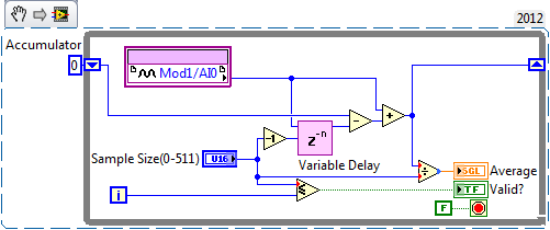

This should work, although it is untested.  You can duplicate the Z-n blocks for more delay(sample size).  If you use powers of 2 for sample size you can use a bit shift to do the division and save space.  The average won't be valid for the first n samples.
Edit: Had the subtract inputs swapped.
This solution looks fantastic.
I am just wondering if the Z-n block outputs correct delayed sample each cycle.
If yes, it means Z-n block has internal array intrinsically.
Have you ever validated the delayed samples are correctly aligned?
