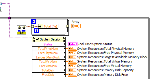

LabVIEW RT 2013 NI-9068.
I am using the System Session information to look for problems.
this is the result
why is the Largest Available Memory Block, Primary Disk Free, Primary Disk Capacity 0?

Property nodes execute in sequence. You got an error after the 3rd property, at largest available memory block, so that and everything else returns 0. Since linux uses virtual memory, that returns an error. I personally think thats pretty lame and it should return some sort of meaningful number, but oh well.
Edit: This KB talks somewhat about memory on 9068s, and I'd recommend looking at the external link at the bottom:
http://digital.ni.com/public.nsf/allkb/AC6200D19D23C61586257C8D006E6DC2

yes, i was getting an error. thank you.
very little description of which properties are "valid" to be read.
if not valid, it probably should have returned -1 and not error.
Stu
