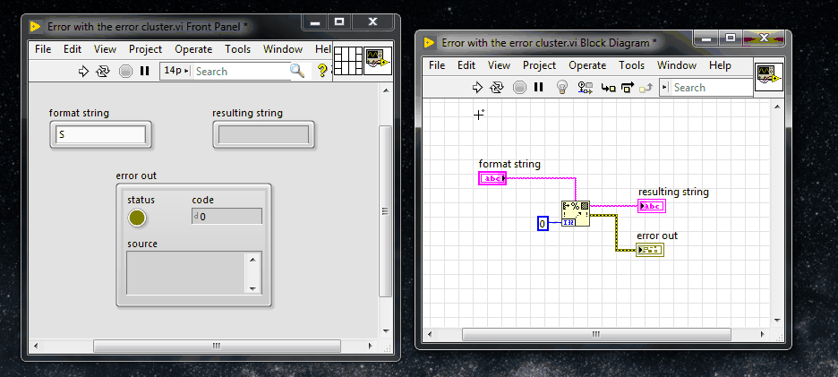

Ok, the attached file demonstrates a problem. The input string driving a "Format into String" node not contain any formatting codes. Consequently when it executes, it returns an error as it should -- unless you turn off debugging. As soon as you do so the error magically disappears. To make it reappear all you have to do is wire an indicator to the formatted string output, and it has to be an indicator, wiring it to the edge of a structure is not good enough.

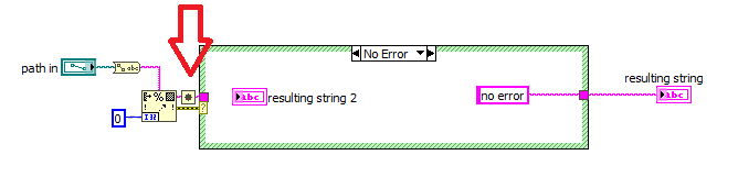

Seems like something is too aggressively eliminating code when debugging is off. Note that the old "always copy" inserted into the string fixes things (see picture). 😮
It sounds somewhat reasonable, if there's no format string the block is a no-op and it's cut. Interesting.

Regardless of whether anything will be fixed as a result, I think it would be hard to argue that what happens below is expected or intuitive as a LabVIEW user.
This is the behavior whether debugging is on or off.

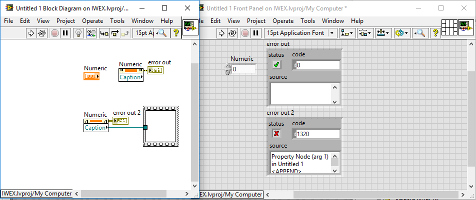

It's almost the same for some property nodes:
Note the control has no caption...
Also note that in this case, wiring to a frame is enough.
