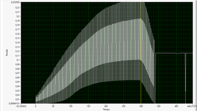

"Okay, so I was plotting a graph, and I noticed this issue with the graph. What can I do to solve this?"

You don't have a problem with the graph, but a problem with the data or how it is wired to the graph terminal.
A graph displays data. It does not modify data!
What is the datatype of the xy data (array of points? cluster of two arrays? Complex array? dynamic? etc. etc.) and where does it come from (read from file? read form measurement device? simulated?)
Since you did not attach any data or VI, there is currently no way to help you.

The only flaw I can see is that the colors are ugly.
Try using some non-ugly colors.
Message 3 of 24
(1,878 Views)
All colors are near default, (white trace on black background with green grid and yellow cursor.). The green grid almost hints that this is not an xy graph, because that would have a yellowish grid by default. Who knows? We don't even know what "issue" the OP had in mind.
I any case, we need to primarily fix the code (and maybe the data). We can worry about cosmetics at the very end.

I was just being silly because the OP gave us virtually nothing to go on.

Replace the Chart with a Graph control! Nice catch C!  And I think that might be a sweep line if the Chart is set to update that way.  🤔  the silly part is not posting the code!
Message 6 of 24
(1,820 Views)
It looks like you've merged 3 plots into one. For multi-plot each should be a cluster and you send in an array of clusters. Check the help.

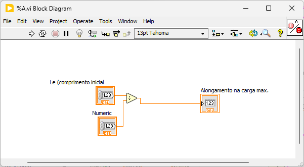

  • Indicator: This is the VI I'm using to generate an array of results from a traction machine. There are two indicators—one receiving data from COM port 3 and the other from COM port 4, representing force and distance respectively.
  • Greater than 0: A conditional check to set any incoming value less than 0 to return as 0.
  • Lalit (a helper function): This function creates a new array based on the first 30 results and continues generating data in that sequence. The results then pass through a threshold. If there’s a collision (threshold met), the experiment halts, and all data is logged in the Reserved section. At this point, the graph becomes visible.
I know there are many areas for improvement, but I've been using LabVIEW for less than six months, and this is the best I've managed so far.

It seems the "download all" button here is broken, so please create a single zip file before attaching. Downloading a pile if VIs is tedious.
Also make sure that you tell us the name of the toplevel VI that contains the "graph" so we don't need to  dig around. Also don't use special characters such as "%" in file names.
Don't you think it overcomplicates things if you replace a simple divide with a subVI? Why-o--why-o-why???

Sorry about that! I think when there are more than 10 files, it blocks the "Download All" option.
The reason I use a VI for this is that I wanted to use it in multiple places and needed a way to differentiate them, so I created a VI to help keep things organized for myself.
