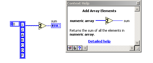

How to add hexa decimal numbers that are got in an array. An array size of 11. I need to add each element.

Or, more simply, by wiring the array into the Add Array Elements primitive from the Numeric palette.

The output of the AAE primitive is the same type as the input, so you shouldn't have to worry about overflow.
Also, it should be noted that the solution posted by muks could be simplified by removing the Index Array primitive - you can just use the value from the indexing tunnel.

Then adding say several U16 numbers overflow may occur quicker than you expect. It was just an heads up.
