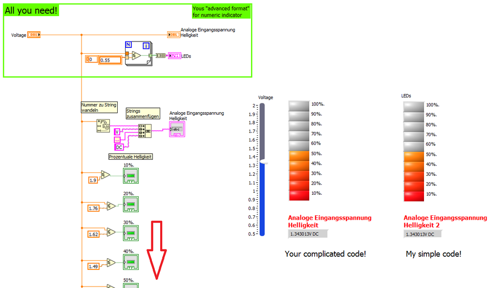

Don't call them "timers", these are "waits"! As you figured out, they stall the dataflow until they are completed. Waits are only useful if they are short. Longer waits have no business in any serious program.
You need to turn your program into a proper state machine. One state would be one that checks elapsed time and compares it with a threshold. One simple way to do poll elapsed times can be found in this example
Some of the rest of your code could be simplified dramatically. For example you could use arrays of LEDs instead of all these individual LEDs and comparisons. Have a look at this example, 90% less code!. (Since you want multiple colors, you could use a cluster of LEDs and convert the array to a cluster before display. You could also use an array of colorboxes.)
(3,517 Views)
Here is a simple example for that. Also used the advanced format of a simple numeric indicator. No need for strings!
