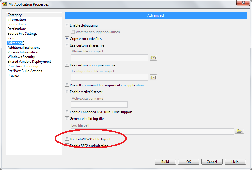

build options.pngHi
Hi jyang72211
Have you tried the use LabVIEW 8.x file layour option on your build spec? (see attached image)
Steve
Message 2 of 14
(4,909 Views)
I am using the 8.x layout now.
