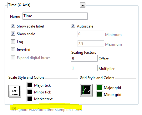

I've got a waveform and I want to plot the data against the absolute time. In the graph properties I set the display format to "absolute time", but it didn't work.

I am not sure why this is happening, but your scale ignores the timestamp, but that option is grayed out...
I am not sure why it happened, as it happens for newly created graph elements as well. Modifying the t0 and delta t, i managed to create a graph which does not gray out that option, but with the default settings, there doesn't seem a way to get this to work....

With your help I found the solution.
See attached screenshot.
Nevertheless it seems to be a bug that the option is grayed out in the properties dialog. At least it is missleading.
