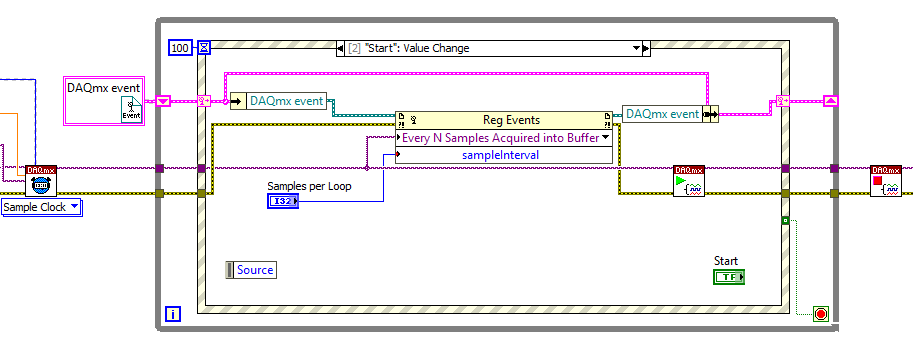

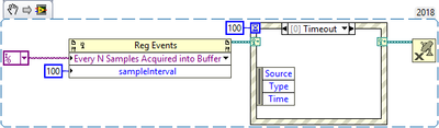

  1. Make a constant DAQmx "Dummy Event". I often use a cluster, for some reason it works better when mixed with User Events.
  2. When you have a real task at hand, the register for it inside the loop.
See below. (The first picture occurs outside the event structure. The second picture occurs inside the event structure.)

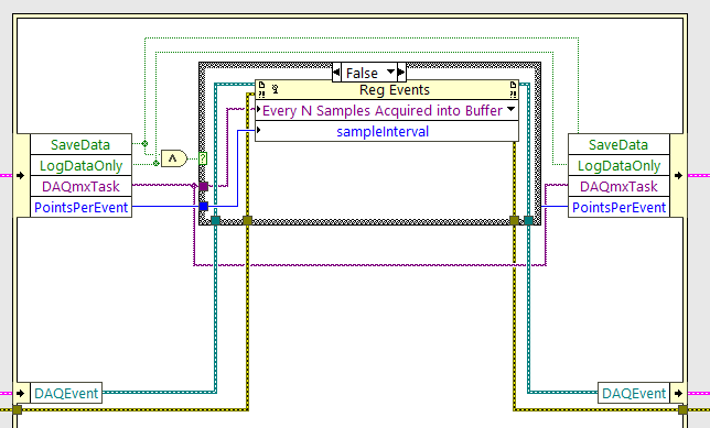

I got the access violation in LabVIEW2018, DAQmx, version 18.x, not sure, not in front of that computer.
Attached is a 2018 VI and 2019 snippet.

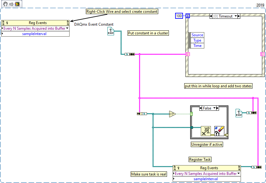

This is what I do to get it to work, note if something major changed in DAQmx 19.5, then all of my programs are hosed, because I do this all the time. Also note I don't have a DAQ here to test.
  1. Right Click the DAQmx Event node and choose create constant.
  2. Put that constant in a cluster, I remember this was key for some reason. Use that cluster for event registration.
  3. Unregister if active.
  4. Register with real task reference, then rebundle.
All should be in a while loop state machine.
mcduff

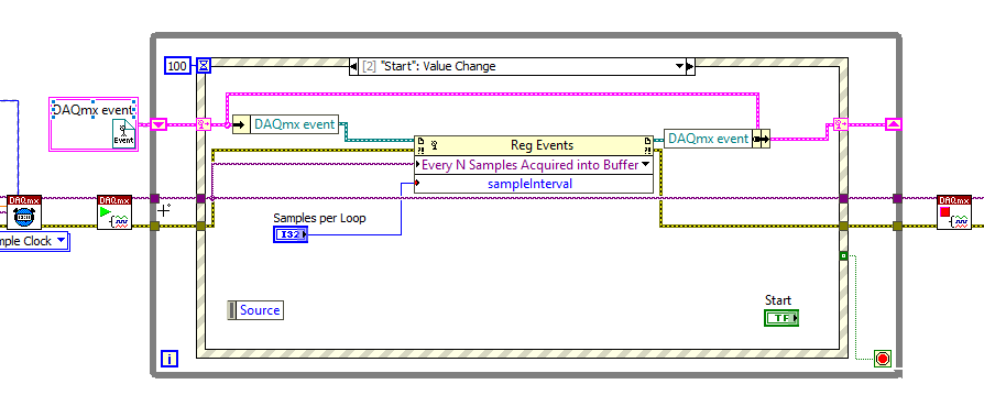

Whelp, guess that's what I get for assuming. I was aware my Start was before the registration, which I assumed would just mean the buffer started filling before the event was registered, so I ran the risk of the buffer overflowing. (That's just in my simplified code, not the real stuff). Apparently you cannot start a task, then register it. You must register it first, then start the task, otherwise you will get a hard crash in the dev environment. I still assume this is a bug- if I can't do this operation it should throw an error, not crash the development environment 🙂 I'll work with NI to get that filed as a bug report, but for the time being I'm all set, and both my test code and the real thing are working.
So I've finally nailed it down. I don't know *why* this is the case, but it works.
This code works:
If I move the Start Task to before the loop, it will hard crash LabVIEW:
I haven't poked enough at it to understand if it's because of the original Dummy event or not. Unregistering the dummy event doesn't seem to have anything to do with it, though if there was a real event there I would obviously need to unregister it. The particular version of code I used to snap the images just didn't have it in there as I was taking stuff in and out to try to isolate what the heck was causing the issue.
