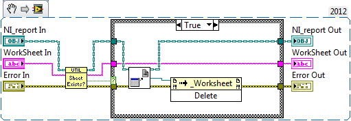

Several years ago (6?), while running Excel 2007 on Windows XP, I tried integrating Excel Workbook functionality into LabVIEW using ActiveX functions to do various tasks, such as reading/writing specific rows/columns on specific Worksheets.  It was quite a challenge, in part because of the difficulty with finding ActiveX documentation.  At that time, there were Help files that were "helpful".
Recently (about two years ago) I tried updating this code to Windows 7 and Office 2010.  However, the Help Files were now much more difficult to find, and "did not play well with others".  On the other hand, I found that the Excel Object model that LabVIEW had implemented in the reworked Report Generation Toolkit allowed me to do much of the functionality that I'd previously implemented with ActiveX, but in a "documented" and much simpler fashion.  There was still the need for an occasional call to ActiveX, but I mostly use the functions contained in the Toolkit.
I've attached an example, my EXCEL Delete WorkSheet function, which takes an NI_Report object representing an Excel "Report" and a string with the WorkSheet to be deleted.  The function "Sheet Exists?" tries to do an Excel Get Worksheet call -- if it fails with error -41110, then the Worksheet does not exist (and this particular error is cleared).  If the Worksheet does exist, I use the Get ActiveX References function to get a reference to the Worksheet, then use the _Worksheet Delete method to delete it.
I just looked to see where else I needed ActiveX references.  Here are the functions I needed them:
  • Sheet Limits, to get the number of rows and columns used on a particular Worksheet
  • Column Limits, Row Limits, similar to Sheet Limits
  • Sheet Size, identical to Sheet Limits (I didn't realize I'd duplicated my efforts!)
  • Workbook Active, tests if the Workbook Object is still open (fixes a bug feature of the Report Generation Toolkit)
The Workbook Active function was needed to handle the following situation -- I was using the Toolkit to open, modify, then save and close an Excel Workbook.  What I didn't anticipate was that if the Workbook was closed "manually" (using the "Close" button in the upper-right corner), and then LabVIEW tried to Save/Close the Workbook, NI's code would delete (without asking) the already-saved Excel file!  This was brought to NI's attention -- they may change this behavior, but then again, maybe they won't ...
So before I forget to attach it, here is EXCEL Delete Worksheet:
