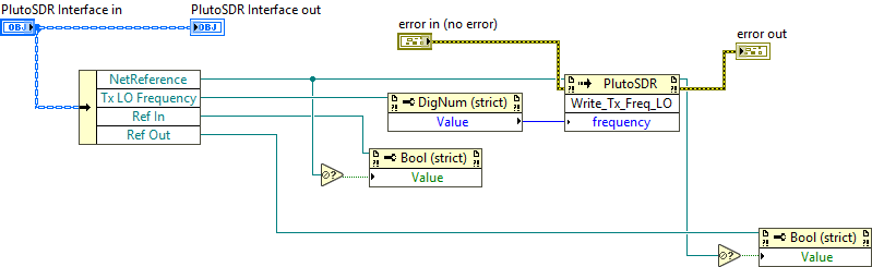

What is useful to you? I have reduced the actor data to nothing but some front panel references, and the .NET reference. Here is my one actor method that I run (besides creating the reference and initializing). Here I check NetReference before and after the method to see if it is invalid. When the error is thrown, the reference is invalid immediately after reading it from the actor private data.

Ah, then what I was thinking may be happening probably isnt. I was thinking you may have a method somewhere that you are passing the default value of the actor out of the method, losing your active reference - but if you have other references in class data, that probably isnt the case.
Even without the hardware, seeing your code may be helpful..
