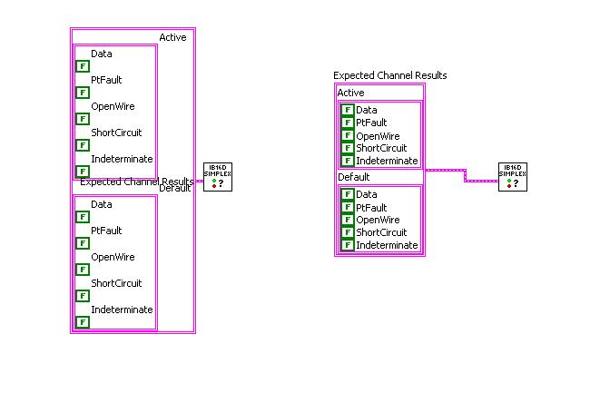

   OK so Enviroment|Create Constant Lables Helped a little, but (see below) the left hand cluster is what im getting, and the right hand structure is what I want, any ideas?
Cheers, Alec

That is just a matter of label location.
I believe 2012 just got some new options for the default locations.
Question:
Have you concidered viewing your cluster constants as an icon and when you want to remind yourself what is in the cluster, ctrl-h (show help) switch to wire tool and flaot over the wire?
It will give you more info than just the labels and you will avoid the "explosion" that occurs when you add more elements to the type-def.
That is all I can offer at the moment.
Have fun!
Ben
I agree that labels in clusters are a bit of a mess. Here's a related idea you might like.
