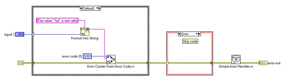

The best way is to use the error wires. What you need to do is:
  1. Detect the error - You can do this using comparisons (greater than / less than) in your case, but it will depend on your scenario. You can also do it using a case structure, in my example I said that the values 1 through 100 are valid, everything else (default) is not valid.
  2. Trip the error - there are many ways to do this, including a simple cluster bundle, but I like to use the "error cluster from error code" VI, which makes it very easy to see what you are doing. Give it a meaningful message, and stick to the custom error codes range.
  3. Skip any code that doesn't need to be run - You can do this by putting a case structure on the outside of it and making the error wire select the case. This is why a lot of SubVIs have a case structure around them.
  4. Display the error - You can do this with the Simple Error Handler.
