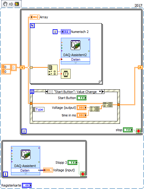

@Godeko wrote:
But Im not getting the part where I have to make it recursive and run it without and pre-existing array.

Thank you very much guys. It will take me some time getting used to the shift registers, but this tool opens many more possibilities.
I got stuck on the idea of recursive functions that I didn't see this option.
@altenbach wrote:
@James.M wrote:
You have the right idea with an event structure. You want to combine an event structure, a While loop, and preferrably a case structure to create a State Machine. Your array can be stored in a Shift Register from iteration to iteration and appended to within a specific case or just within the event structure.
Here's an old example that you can modify for your purpose. (originally posted here)
(you could also use a feedback node instead of a shift register)
Ive modified the example and got it working after a while.
Thanks!

Seems to work. Good!
Some points:
  • Please do not maximize the front panel and diagram window to the screen. That's extremely annoying because you can only look at one thing at any given time. You probably need room to also see the help window occasionally. Nobody wants to stare at a gigantic diagram that is 90% whitespace.
  • A good rule is to place the terminal of latch action booleans inside their respective event. This way you can verify that the event actually fired. Especially important with more complicated code. (If the terminal is not in the dataflow and read, it would not reset to false)
  • You might want to initialize your shift register with an empty 2D array constant. Currently, the shift register clears when the stop event executes, but if you would abort the VI, the shift register contents content are retained until the VI leaves memory.
  • Typically you would rename the label and boolean text to something reasonable. "Start Button" and "Start" are not descriptive of the current functionality.
  • Since the array can grow without bounds, I would show the vertical scrollbar of it.
Message 8 of 10

Thank you very much. At the moment its quit messy as I just try to get it working in any way, but I will keep it in mind for the final product as its going to be used my external users.
I have one more question or problem which came up working with the new array mechanic.
I need to give a small explanation on my project to understand it.
My project is programing and setting up a galvo system, where one can basically set up a angle of the galvos = output voltage of the DAQ.
As I already stated, this system has to be useable by other scientists which dont have any clue about the program.
What I want is that one can set different voltage values (first column) and times (second column). The output switches the voltages for the respective times. When it reached the last value it starts over again.
I got it working with a simple array one can modify (see voltageswap NI forum.vi), but I want it to feel more intuitiv. Thats why I wanted this function I asked my initial question for.
I tried to implement the solution I linked in my last post, but the problem is now that:
  • After reaching the last voltage, the for loop doesnt restart
  • It only adds new rows when the loop reaches its end. I want it to restart the loop as I set a new value
You can see it in the file voltageswap add NI forum.vi
The second while loop with the voltage analog input is just there to link the output to the input and check if everything is alright (which aperently isnt as already stated).
Im using a USB-6002 DAQ but that shouldnt be the problem.
I probably didnt understand the event and while-loop mechanics right and would be really happy if one can give a clue on what is wrong.
Thank you!

Hi Godeko,
THINK DATAFLOW!
The FOR loop will restart as soon as the While loop starts the next iteration.
The While loop will start the next iteration as soon as all its included functions are finished.
The event loop is finished as soon as you press the Start button - as you configured it…
On your VI:
Why don't you use AutoCleanup?
Why do you index those array values in a very complicated way?
