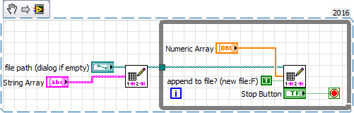

Use the "Write Delimited Spreadsheet VI"
Here is a very simplified example of writing strings like say column headers and then rows of numerics to a spreadsheet file.

(7,964 Views)
My string data is not an array, its just title information that I am building and bringing together with the concatenate strings.....then I want to write it to the top of the spreadsheet.
Thoughts?
Thoughts?
So make it an array (use the Build Array function) and write it first, then write your numerics.
