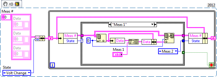

I am building a VI that controls several instruments and then takes data from these measurements and applies them to calculations relevant to material science, such as resistivity and Seebeck effect. I have created a state machine that establishes a voltage level and takes three sets of three different measurement points using a Keithley 7001 scanner and Keithley 2182 nanovoltmeter. I am now trying to figure out how to take the measurements and put them into three seperate arrays so that I can use them for analysis later. I prefer arrays because there are several VIs that can help me do what I need to do easily (such as the Mean VI), but if something else would work better I am open for input.
My simple question: What is the best way to take the measurements from the cases Meas 1, Meas 2, and Meas 3 and place them into three seperate arrays?
I have attached my VI.

In this example below, I used a structure called Meas #. This structure allows each meas to have it's own unique array.
The structure is an array of clusters. The cluster contains a string array called Data.
Hope this helps.
